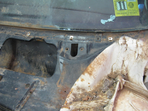

Heres another one that is obviously very original.

Now thars an original...
