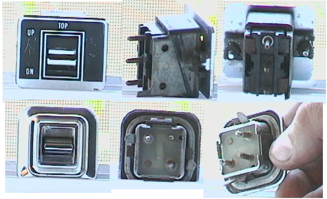

  108. I'm trying to locate an original 1968 power top switch, but have not met with much success. Would any other power top switch from another type, like an Impala, work, or could I make use of a window switch?
    Flash, 25-Jun-1999
    The 1968 switch is 3897314 but there are no on-line part number hits for it. The 1969 switch is 3959230 and has several places reporting it in stock (see below).
    The 1969 switch is completely different than 1967-68. The 1969 is a toggle-type switch that is mounted in a bezel on the dash, looks just like a rear defogger switch. The correct 67-68 switch is rotary and mounts on the bottom of the dash cluster. The 1969 switch is the same as the wagon power rear window switch. GM serviced a "generic" black toggle-type power top switch for a while. In fact, there is a 1969 switch listed on ebay right now - so I'm going to borrow the picture to show that one. Click here to see the 1969 version of the switch.
    While the 1968 parts search was empty, the 1969 part search shows the following:
    Stocking General Motors dealers for parts:
    3959230
    Qty  Dealership           City       St    Direct       National
    1    L.E.S. AUTOPARTS     DAYTON     NJ    732-329-6128 None
    1    CONNECTICUT GM PARTS DARIEN     CT    203-655-8529 None
    1    CHICAGO AUTO         CHICAGO    IL    773-254-2414 800-313-2414
    1    ROBERT DENOYER CHEV  HOLLAND    MI    616-396-2333 None
    3    CLYDE REVORD MOTORS  EVERETT    WA    425-353-3199 800-729-7573
