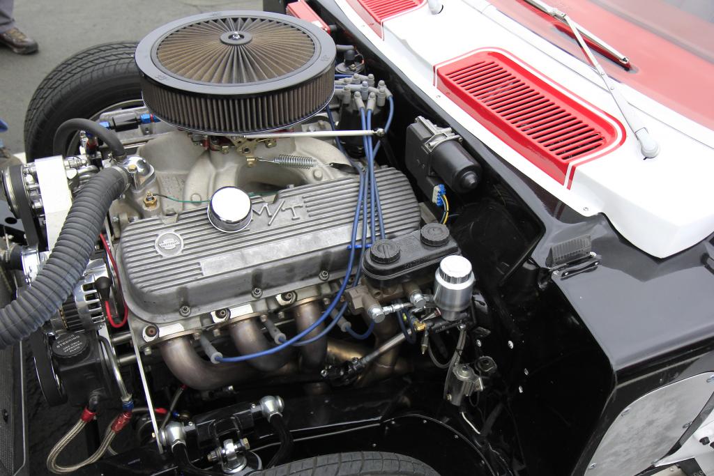

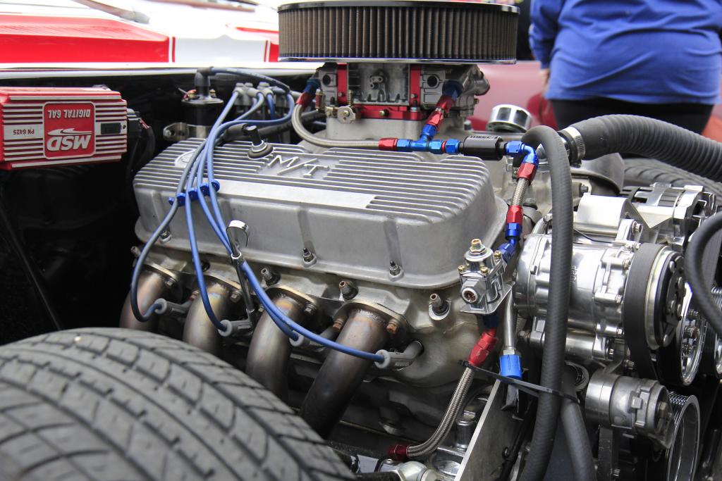

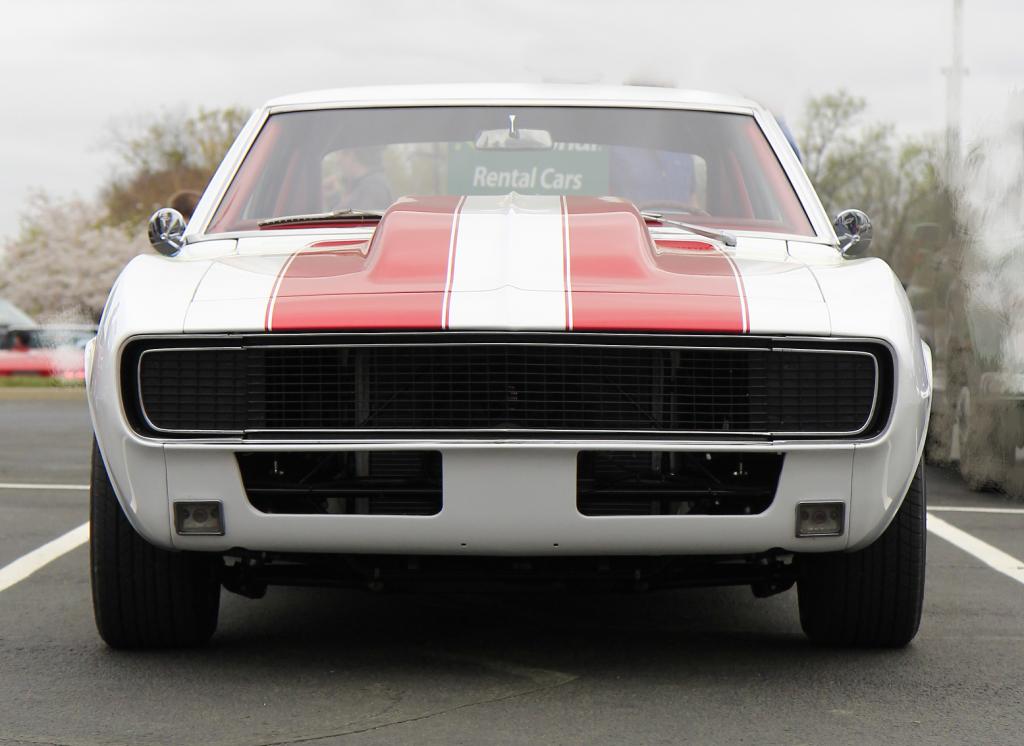

The engine is set back with a flip frontend which slides into place so there is no external indication of it.
Engine 577 CUI All aluminum big block with ac etc
Hand fabricated exhaust and fuel tank by Quain.

Very well crafted car. The roll cage looks like a thing of beauty the way it hugs the pillars, and really cool that tucks up above the headliner. That must have been some time getting it so tight to the body. I couldn't tell if the the headlights were functional or if it was easier to run the RS front end and do without all the extra headlights and trim. How did the front end slide past the tires, or did you notice how does it attach at the bottom?
Re: Quain Stott's 67 Camaro... mildly modified & thrown together
« Reply #5 on: June 11, 2016, 12:50:32 PM »
The inner fenders are sectioned and in the photo here you can see the upper slide catch (just below the wiper grille to the far right edge of the photo) second photo shows the tubular slide and the amount of slide before it kicks up...  it only needs to slide a few inches before it tilts away.
 I thought I had taken more photos but I was obviously just looking at it in amazement, beautiful job TRICK as hell.
It uses a door latch mechanism which latches front and center,
If I remember correctly the headlamp doors are relay activated motors.
