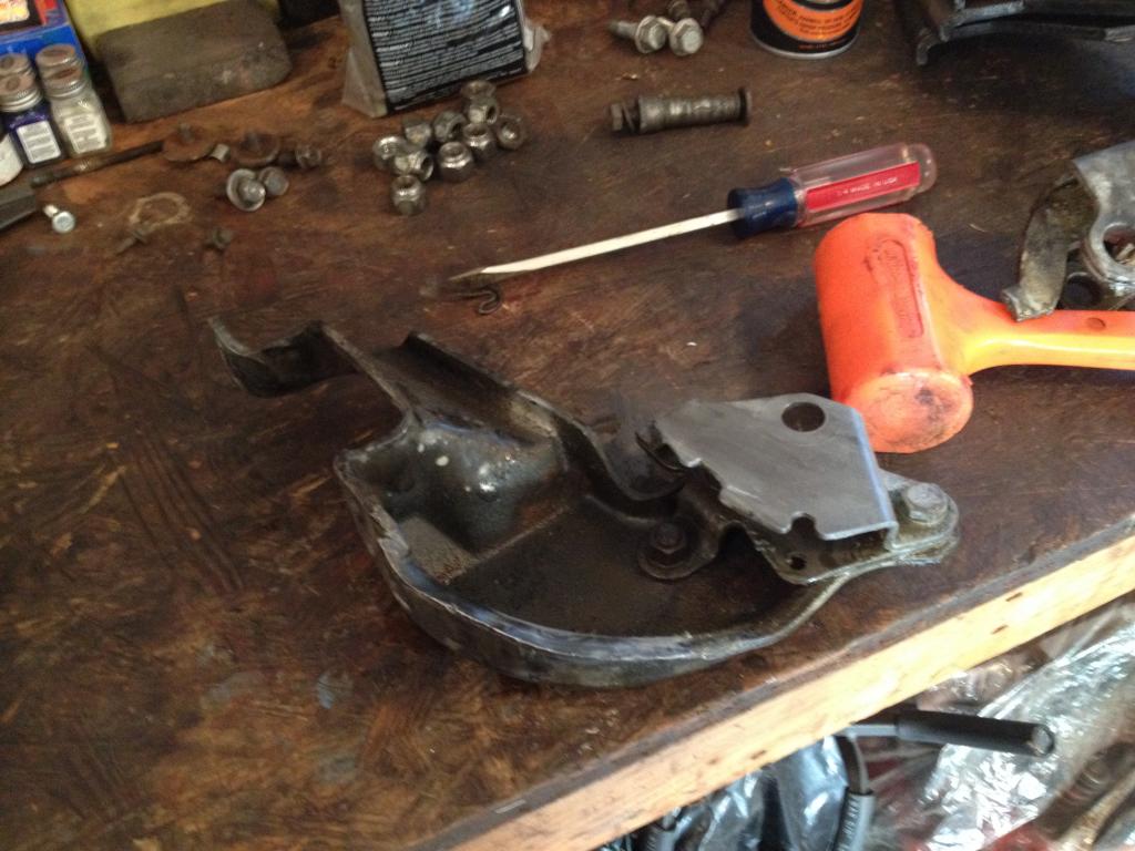

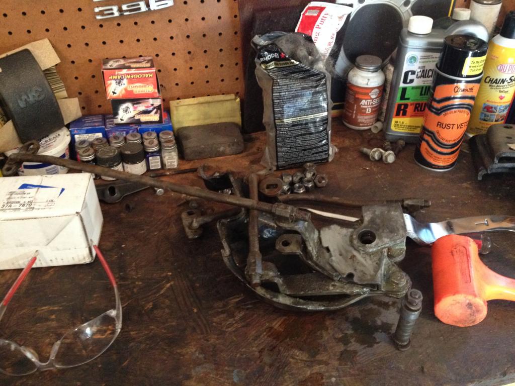

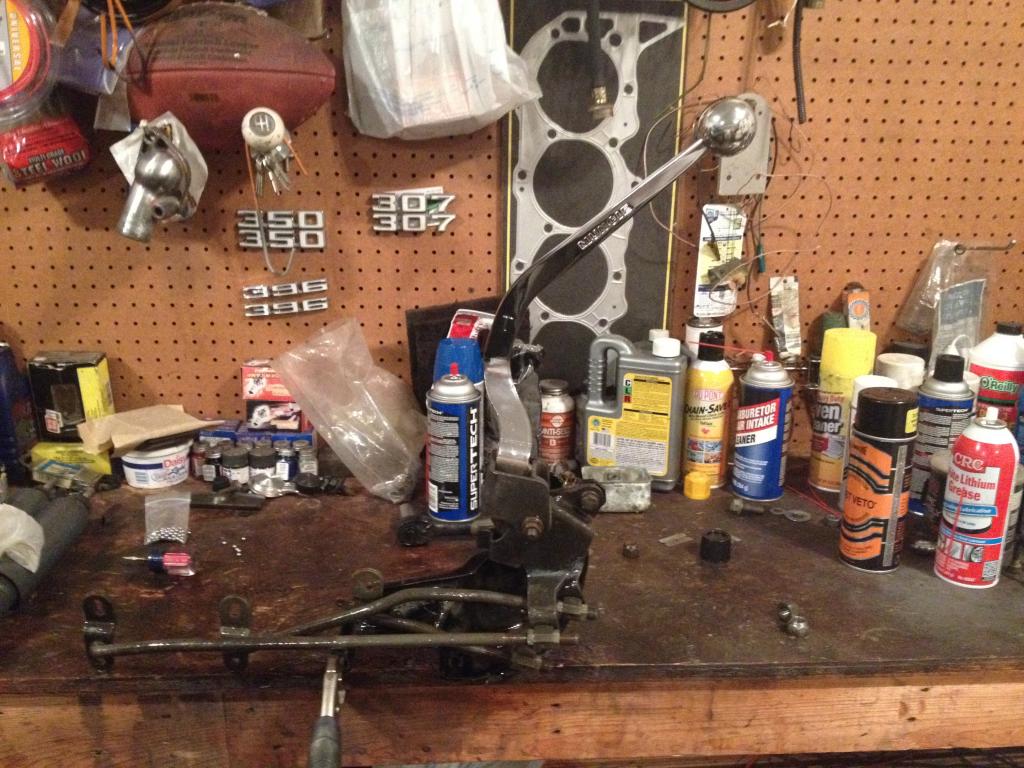

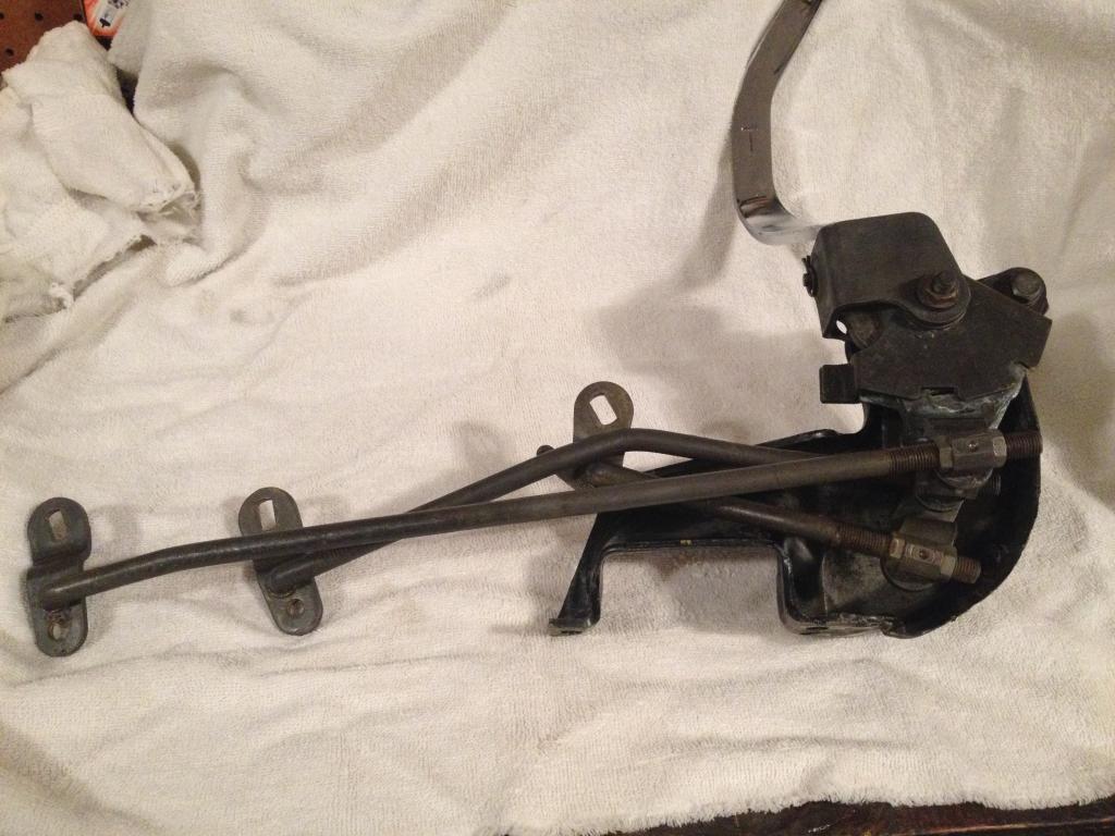

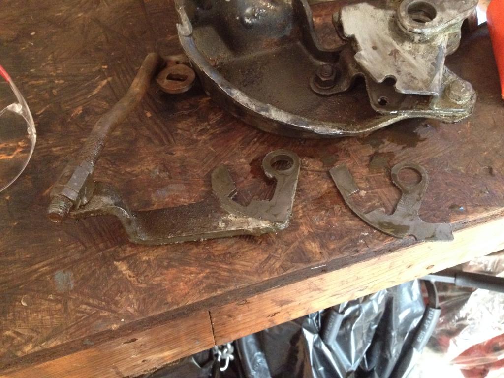

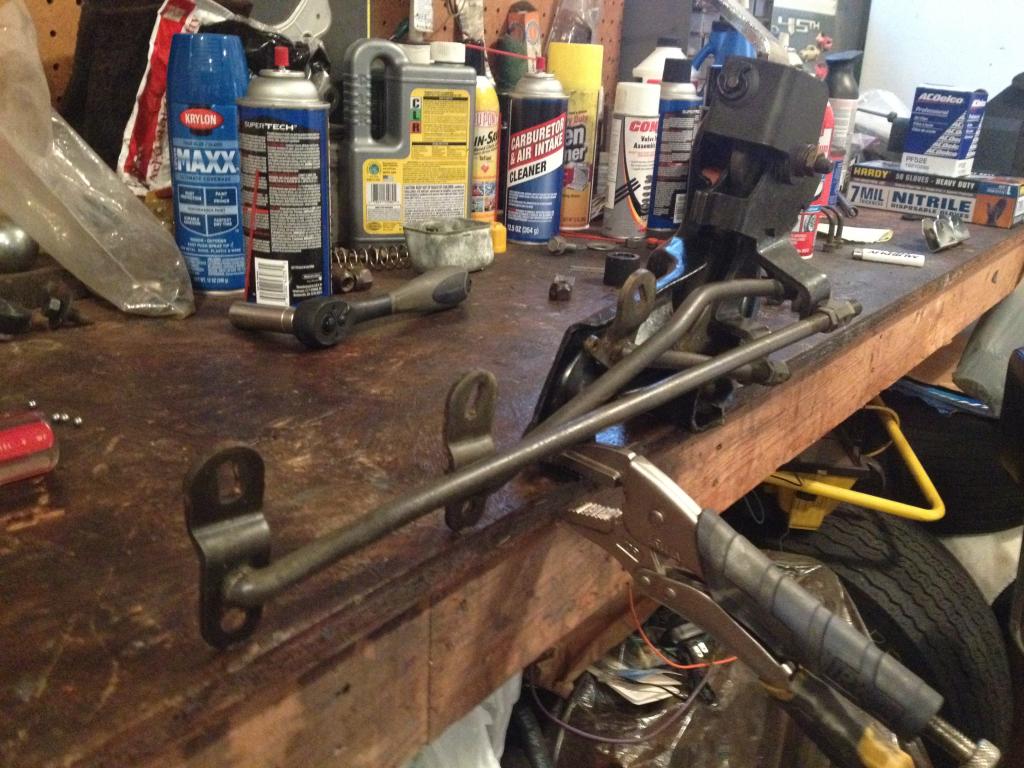

I put this in the Originality section due to this piece being preserved.  Purpose was to remove all rust and inspect and reassemble.  I found a new product on eBay called RUSTAWAY which is considerably cheaper than Evaporust and seems to work just as good.  Also using Cosmoline Rust Veto for the protection of bare metal parts.
Here are the before on the Muncie shifter.
  • Posts: 3986
Re: Muncie Shifter Assembly

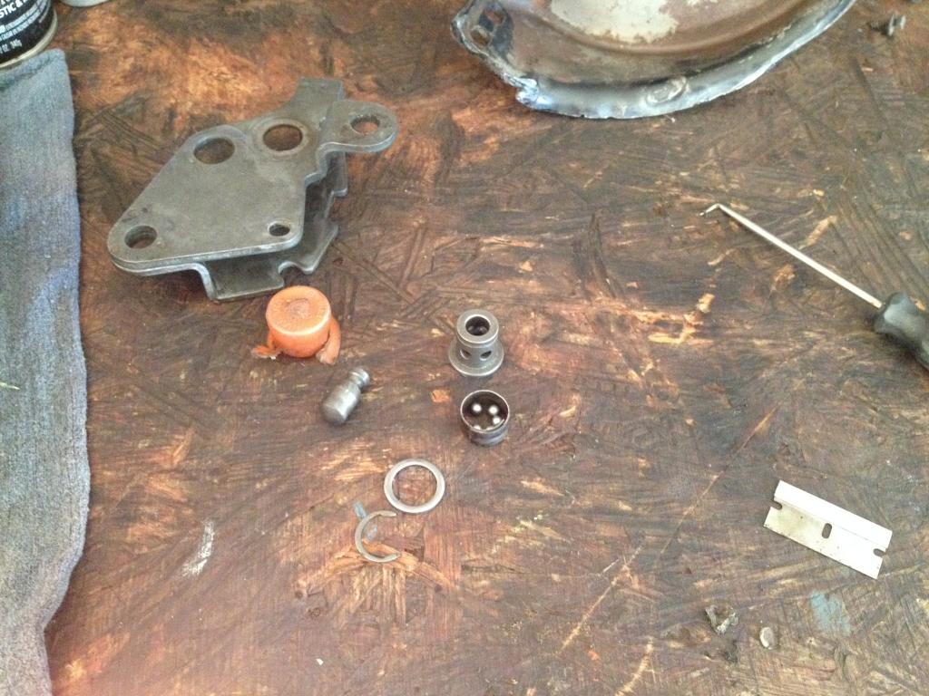

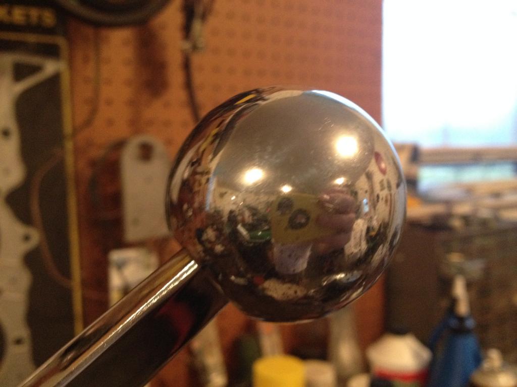

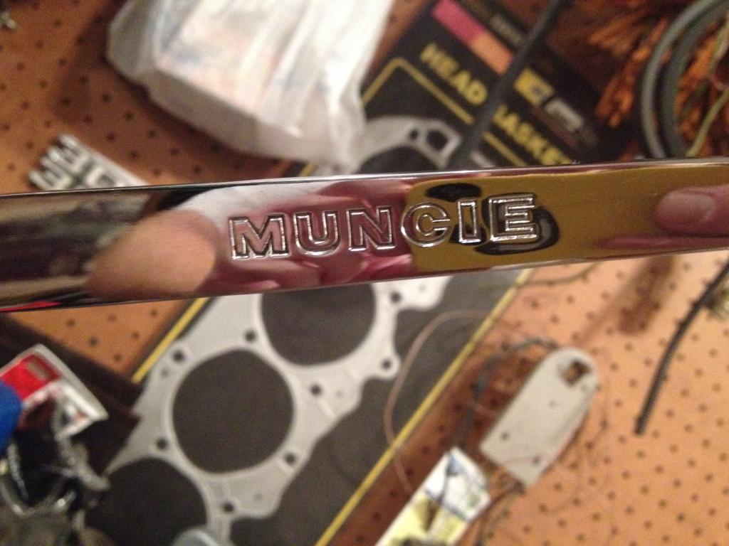

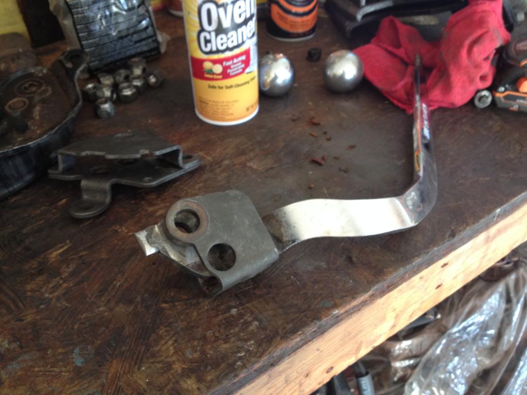

« Reply #1 on: January 26, 2016, 02:26:54 PM »
And the after.  Polished the chrome handle and ball.  I had just sprayed all the bare metal with Rust Veto so ignore the shine on the first pic.  Once it dried you dont see it (see other pics).  Also used White Lithium grease on the reassembly.

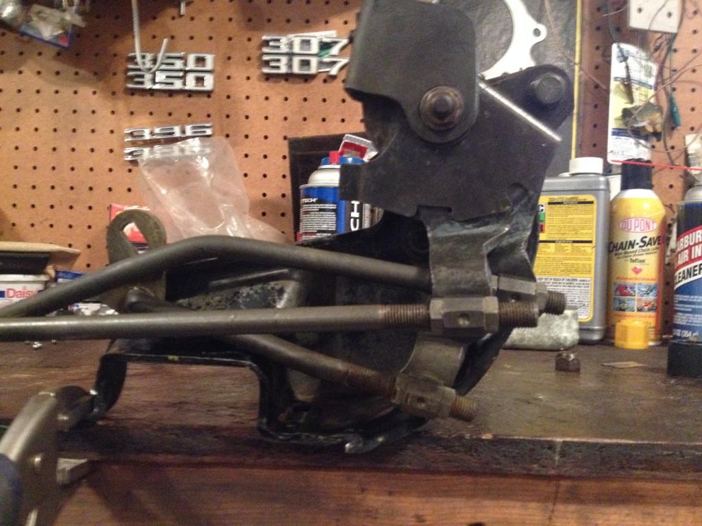

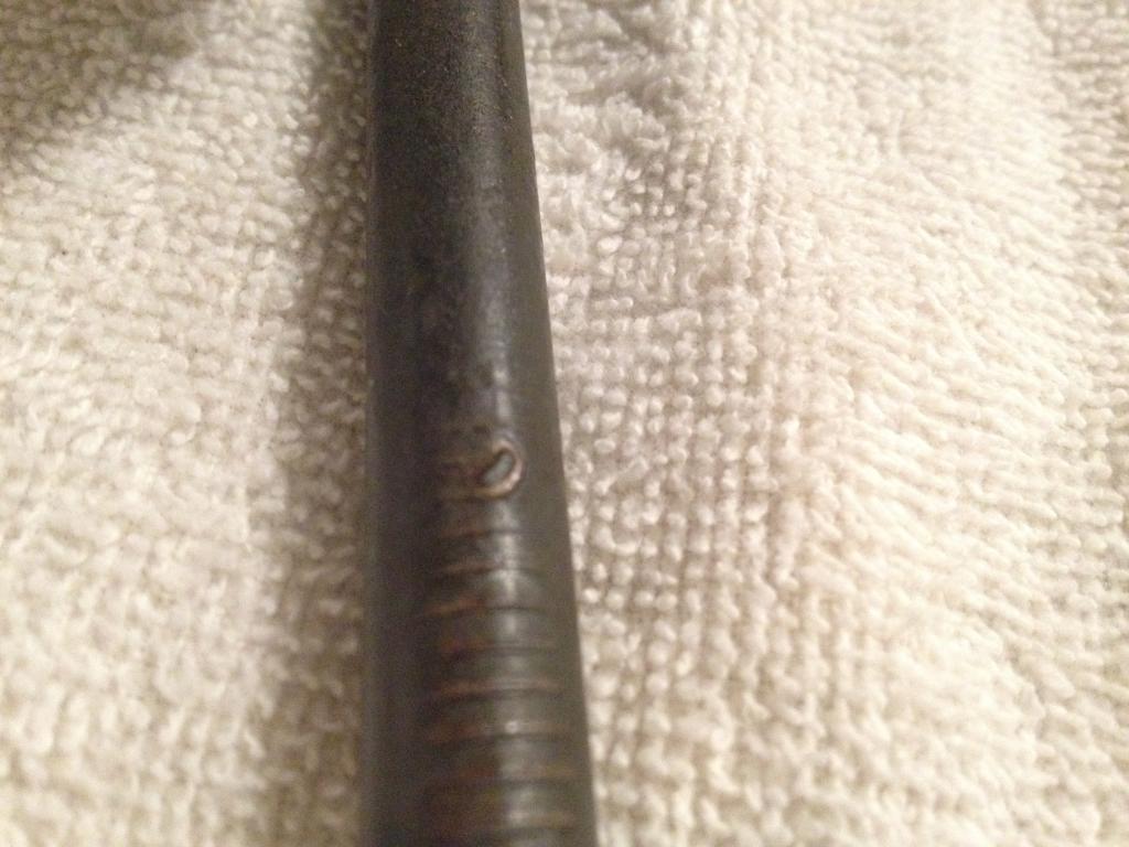

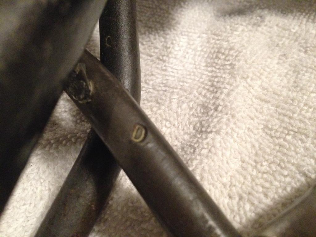

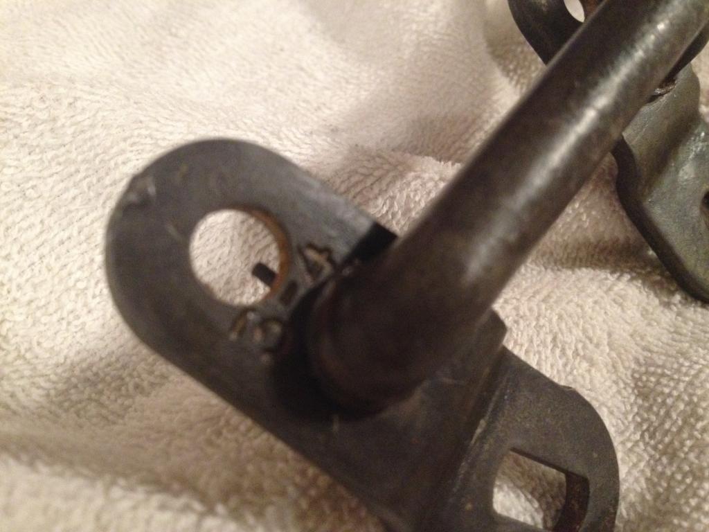

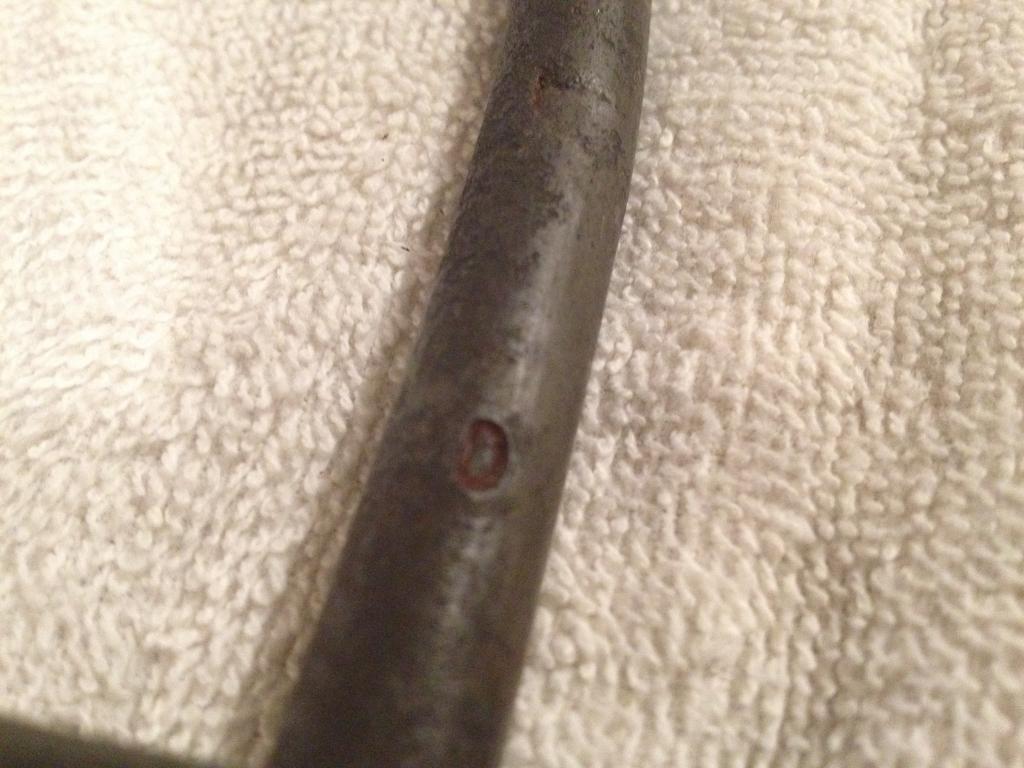

Shifter rod stampings.
  • Posts: 3986
« Reply #8 on: January 27, 2016, 01:55:49 AM »

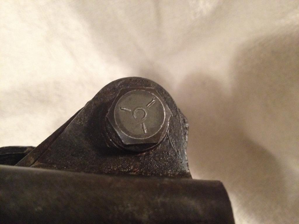

Better shots of the stampings on the rods and a few more shots.

« Reply #9 on: February 01, 2016, 01:07:14 AM »
shifter looks good but looks like it is missing the gate spring and retainer
  • Posts: 3986
« Reply #10 on: February 01, 2016, 02:12:45 AM »
Yep..  I would guess after trying to speedshift at 65-7K the spring and hat was probably left on the road somewhere in northern Ohio back in '68-69..

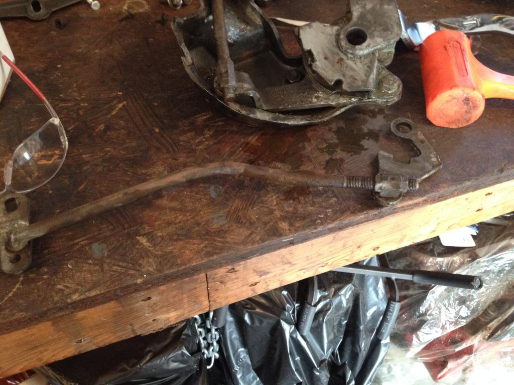

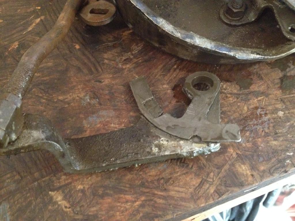

« Reply #11 on: February 02, 2016, 10:58:05 PM »
The rod and bracket are still on the transmission.

Hi Darrell,
    Does the rod and bracket look painted or phosphated?
Thanks,
  • Posts: 3986

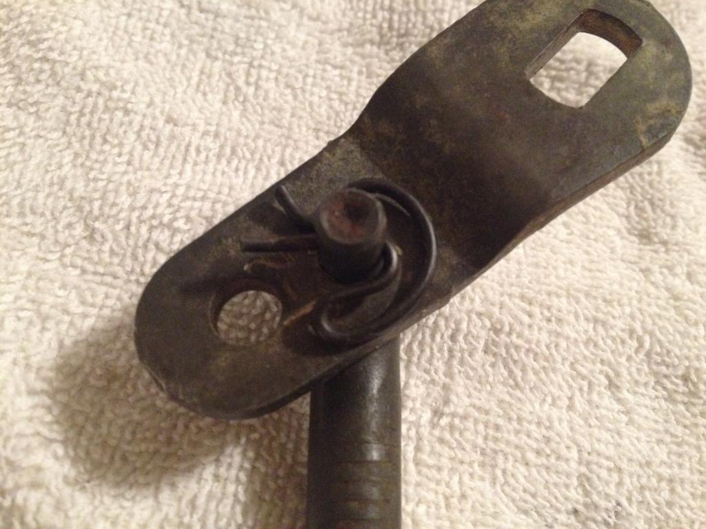

« Reply #13 on: February 03, 2016, 12:46:14 AM »
The rod is rusted so I do not know what it is at this point..  Its hard say and its hard to get a pic of them since they are installed..  My gut says phosphate if anything at this point..  Ill slide under there again tonight or tomorrow and see if I can make anything out.
Edit:
I guess I was looking at the shifter rods when I said it was rusted..  I would say phosphate would be the correct finish..
Bracket
Rod

« Reply #14 on: February 03, 2016, 07:07:49 AM »
the trans bracket is  silver cadmium  and the rod is black phosphate on the originals I have
