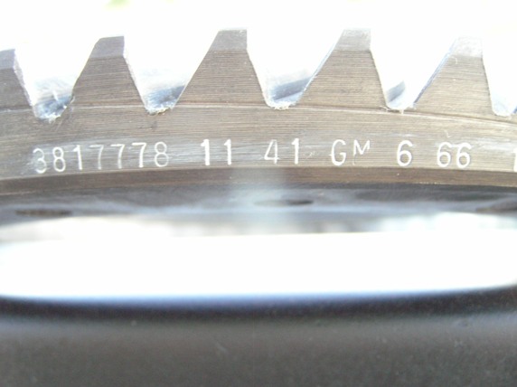

Is there a way to tell what type rear-end differential you have in your car by looking, without taking it apart? I attached pics. It's supposed to be a BS 3.31 12 bolt posi for a 68 Camaro, but really feels very low geared. Thanks.

Count the number of teeth on the ring gear and divide it by the number of teeth on the pinion gear. That will tell you exactly what gear ratio you have.
You can see the springs in the center section so its a posi.  Look on the edge of the ring gear for this..  You wont have to count anything.  Just divide the 2 numbers and thats your ratio..
41/11=3.72727272 or 3.73

Based on the OP pic, Darrell's method is the easiest. Read the numbers right off the ring gear.

Everyone, thanks for the information. It's a 3.73 posi in there, according to the code on the axle supposed to be a 3.31 posi. Appreciate your help guys. Thanks.
