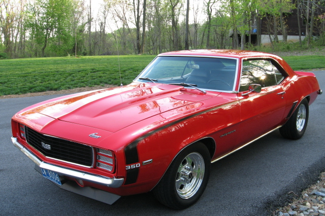

719 is deluxe interior. It currently has a standard interior in it.
What's the build date on the tag?
Price seems in the ballpark, but hard to tell without more info / pictures.
This is the correct stripe for your car:
