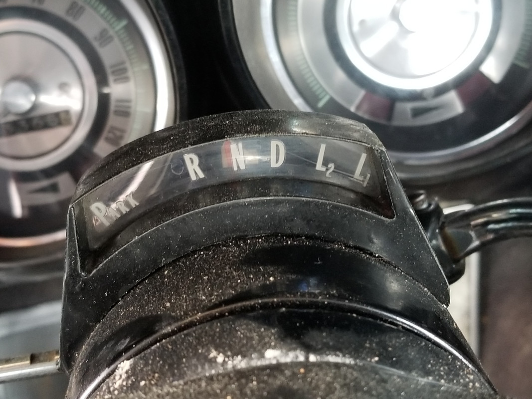

Guys,

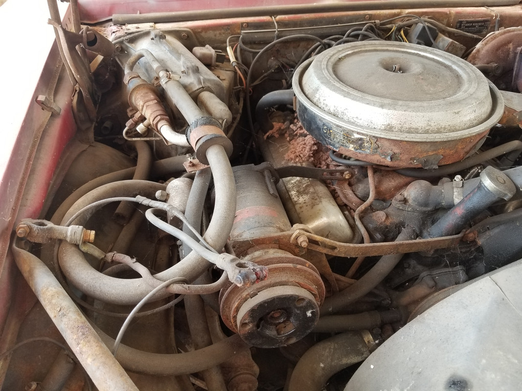

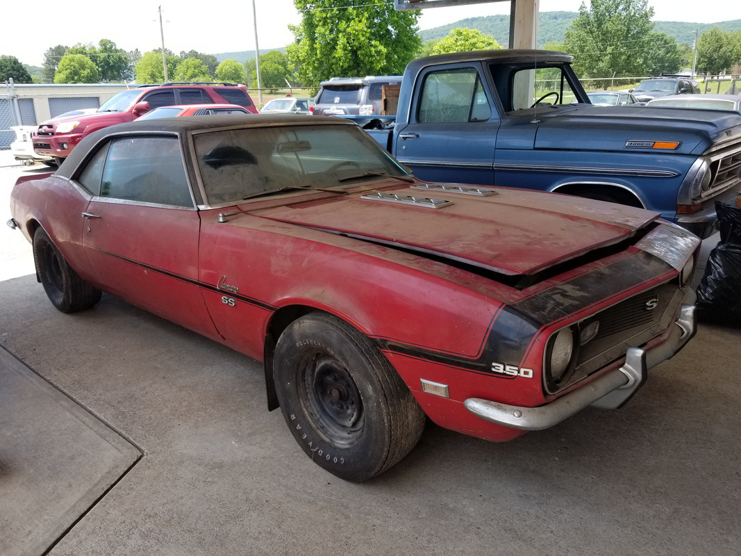

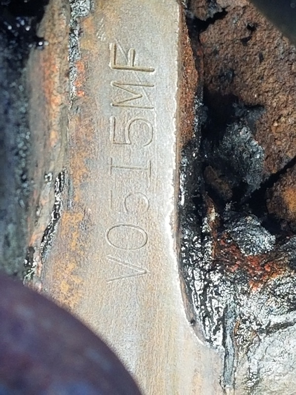

I've been lurking here for quite a long time but never really had anything to add until now, so I guess that makes me an old new guy or something like that...  I've been in the restoration business full time for close to 25 years and have worked on numerous first gen Camaros, but this one is a bit unusual and I'm hoping some of you can help shed a little light on what I've got here.  Rather than say what I think it is and see if you guys agree, I'm just going to post pictures of the relevant details and numbers and see what you guys think.
My customer grew up in St. Clair Shores, MI and purchased this car when he turned 16 in 1973 from a used car lot in Detroit.  He drove the car through high school and college, then parked it in his grandfather's garage in the late 70's where it has been up until about a year ago when he brought the car down here to Alabama.  He states that he replaced the left front fender due to being sideswiped on the freeway, and that's when the car was repainted.  Other than the amateur repaint, the car appears to be exceptionally original and unmodified.  I did note that the left quarter has been replaced and was seamed below the vinyl top, I assume so the body shop didn't have to replace the top, but the owner states that was not done while he's owned it, so it must have happened very early in the car's life.  The interior is completely original, only missing the floor mounted clock which he recalls removing for reasons unknown.  Under the hood is also very original and I wouldn't be surprised if the valve covers have never been off.
So that's pretty much the back story as I know it.  Guy bought the car in downtown Detroit in 1973 and has done nothing but replace one fender and repaint the car since then.  So if you guys wouldn't mind, please look over the photos and tell me if anything unusual jumps out at you.  I'll be happy to provide any other photos you might want, but some may have to wait until we start the disassembly next month.
Thanks in advance for taking the time to have a look and share your thoughts.

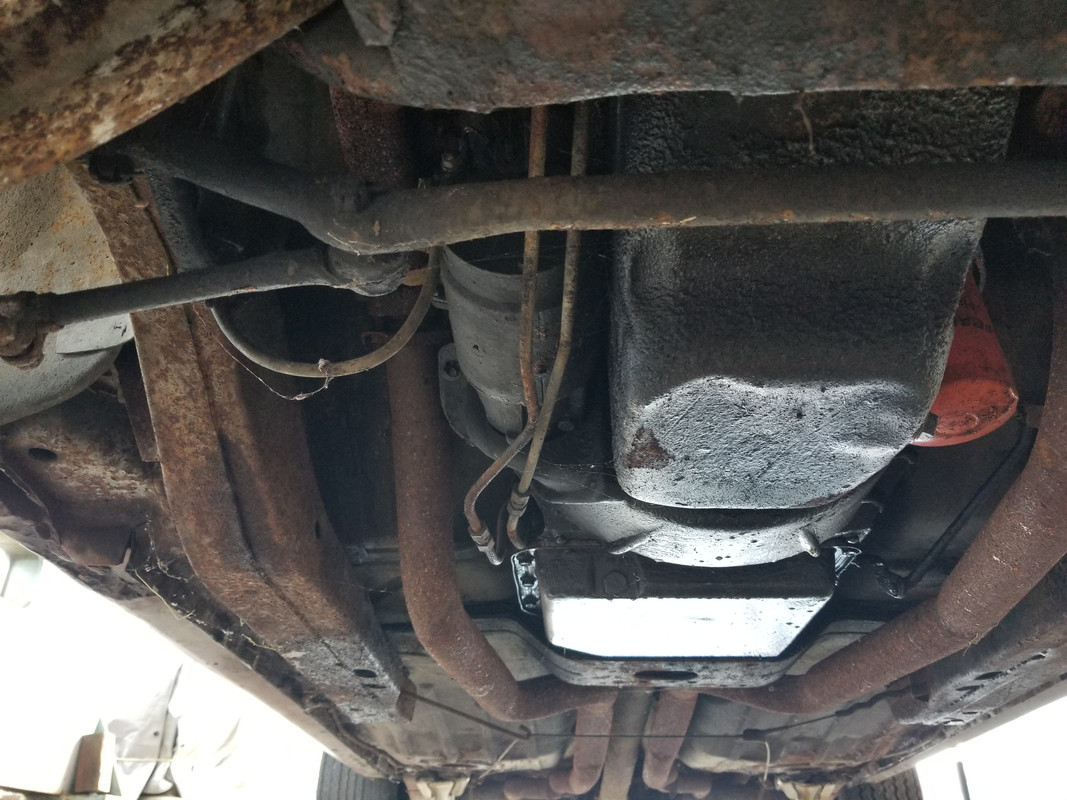

Interesting. Did you find a partial VIN on the trans ? (Near the bottom of the page)...http://camaros.org/drivetrain.shtml#trans
I suspect it may've been a test fleet car...http://camaros.org/trans.shtml#THM350

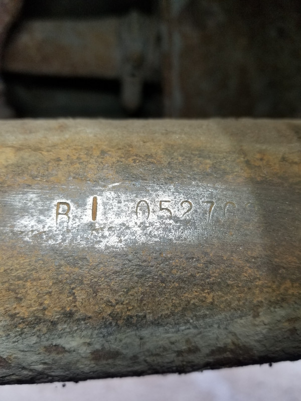

Thanks for the reply.  I had already come to the conclusion that it's one of the test fleet cars but the CRG site was pretty specific about them all being 327 cars, so I wasn't positive.  The "MF" engine code also made me scratch my head.
I pulled the back seat out hoping to find a build sheet but no luck there.  Any other place I might find it?
ETA:  And I did look for a VIN on the transmission but the pad where it should be is blank.  The pan has a 1969 date code on it which would make sense if it were a test fleet car that had suffered a transmission failure during testing.  Here's the pan date code:
ETA2:  It just dawned on me that the "9" on the transmission pan designated the model year rather than the calendar year so it could well be the original pan.  Engine date is May 15 and the rear axle date is May 27, so a May 23 transmission would be right in line with what I'd expect to see.  Hmmmmmm.....

I'm not positive (sure) either, but in the last link I provided, Bryon (BCMiller) made mention of documented L48 cars as well.
There were 2 possible locations for a partial VIN. It's described in the link above. Maybe you'll see it when the engine/trans are removed.
