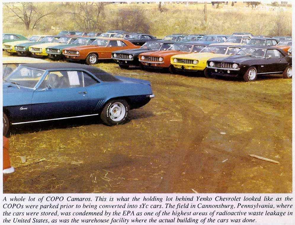

The pic of the Yenko storage lot that circulated years ago shows a car (which I would guess could be an X44) with a vinyl top and no quarter moldings, no Style Trim either. I seen a good number of Yenkos without them. If someone has that pic on file, please post it again if you don't mind.
This one Steve?
This one Steve?
Exactly. I've located several more examples online of Yenkos just like this, no style trim, both with and without vinyl roofs. Memory serves that COPO's were X44's, did Yenko use (early) some X22/66's or primarily 44's ? More than a little fuzzy -

Not true. There were plenty of X11 COPOs; both ZL1-RS for example.
There is a yellow/black vinyl VE3 Yenko here in town; very high likelihood it is the car in the photo. Built with D55, M40, N40, Z21, Z23. X11 tag. At least one other X11 Yenko known to exist.

Precisely how I determined the moldings were never mounted. View of both quarters from inside shows no evidence of filler, brazing, or piercing of any kind. My X77 looks the same way (of course). The quarters themselves appear original, I'll check the date stamps on them this weekend to make sure they are original.

From our Archives Numbers Decoding:
1969 Norwood Camaro         Fisher Code Interpretation
  with Z21 Style Trim             without Z21 Style Trim
  (or Z22 Rally Sport)             (or Z22 Rally Sport)
 X11* non-SS396, non-Z28,    X44* non-SS, non-Z28
      includes SS350                 X55  SS350
 X22  SS396                           X66  SS396
 X33  Z28                               X77  Z28
 * COPO Camaros were an exception, as most COPOs
   were built out of bodies coded with X11 or X44.
   Some early COPOs had X22 or X66-coded bodies.

It's the line about X66 bodies being used that has my interest - maybe the blue car in the pic is one ?
I know - likelihood is slim, but it's always good to imagine. Now, if the JH code 396 sitting in the garage was only an iron 427 block, I'd get really excited (but it's not !).
