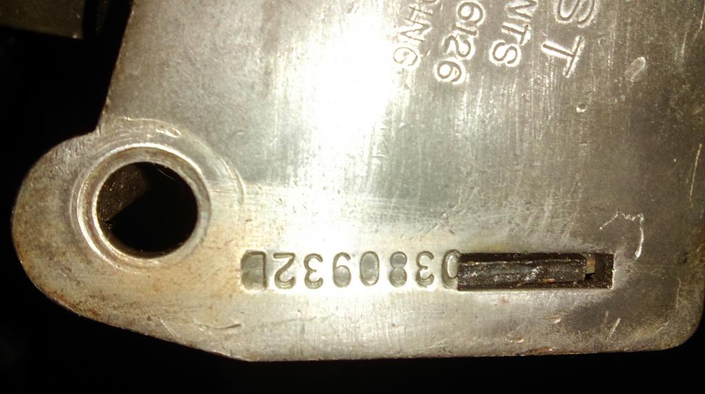

Attached is a picture of my early 1969 Z28 shifter. Build  code 09D 1968 Van Nuys.  The shifter date code is 8 8 D3. The first "8" was stamped real lightly by the bolt.  The rest of the date code is real clear. After I resized the picture the first "8" got more faint.
Thanks,

Date         shifter
09C NOR   890731C
09D LOS   88D3
12B NOR  68B2
03B NOR  19D52P
07A NOR  690711F

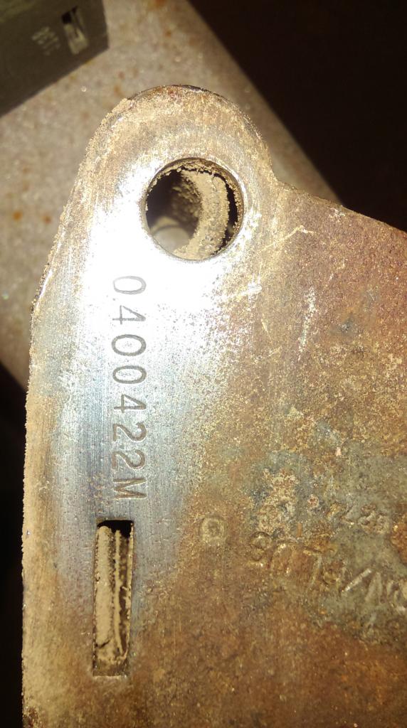

So attached is a pic of the Hurst shifter from my 69 Z, build 10B, Oct 68. Shifter is dated  6  8B2. The 6 is hard to see. I'm not sure this one is on the list? Sorry if duplication.
Jimmy V.
