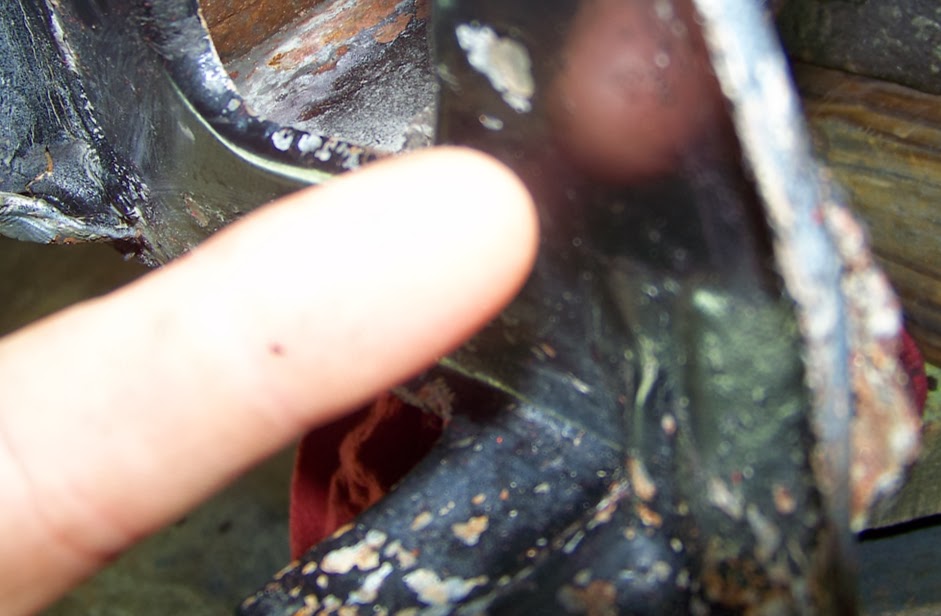

Have a 1969 Camaro Z28 that has been certified by Jerry MacNeish. One of the corrections that need to be done that was
reported in the certification was: "Lower Rocker Area should be painted semi/gloss black below the rocker molding". Car was
repainted years ago and all that area was painted "Hugger Orange" the original color. Enclosed is a picture of the area. Can
someone please post a picture how it should look? What kinda black should be applied. Eg. like Rustoleum 7777 or ??. Please
comment on this. Thanks--Larry

 I don't think you can do any better than GM Reconditioning Black as far as matching the correct gloss level and texture goes.

It's really not a semi gloss, Here is an untouched unexposed place on a 69 SS showing there is a reflection and a good bit of gloss.

Its not really semi gloss but more of a flat gloss.  The black should end underneath the chrome rocker trim about in the middle.  I went through this when my car was certified by Jerry and it has been at the nationals last year with the correction that was done approved.

I agree with Mike S....    GM reconditioning black will be good for that area.. :)
