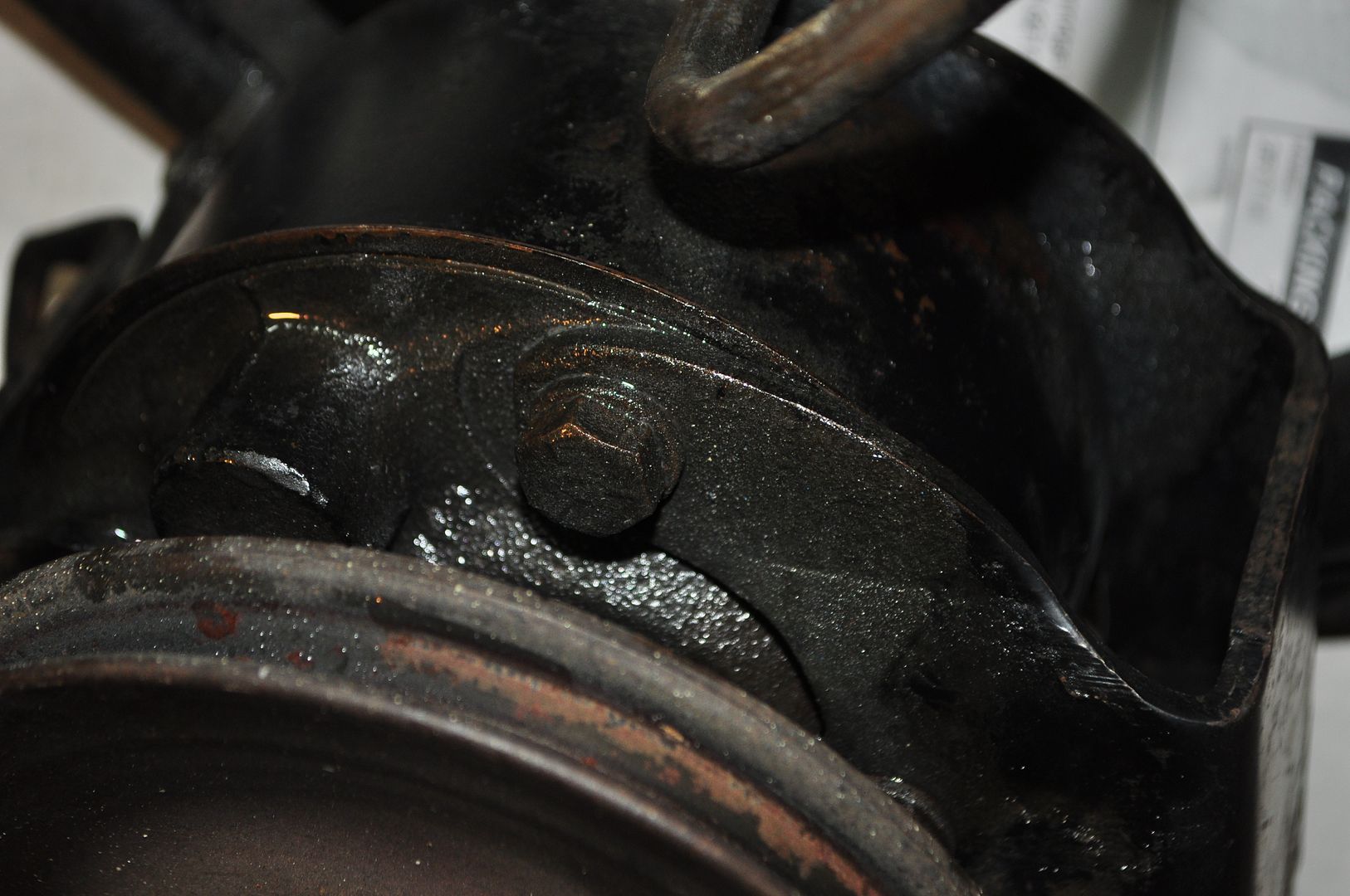

How about the power steering pulley?   I have yet to restore the pump and pulley.  The pulley appears to have been phosphate plated as well.   Compare the finish of the pulley to the pump in the last pic.

Here is a photo of an original '69 Z/28 Power Steering pulley I own. Although the original finish mimics phosphating its definitely paint. In the photo you can see a small area that is chipping on the bottom right side.
Hans L
  • Posts: 380
Re: 69 Z 302 pulley finishes
« Reply #12 on: May 30, 2013, 10:09:45 PM »
Edmontonvillage - Thanks and interesting.  I'll have to inspect the pulley better and determine if it's paint.   Must be a very light paint as it's not obvious like the other components.

« Reply #14 on: June 21, 2013, 04:30:31 PM »
There is no indication it was dip painted (lacks tell tale runs) however its low gloss (at least 44 years later it is). I have not attempted to duplicate it.
