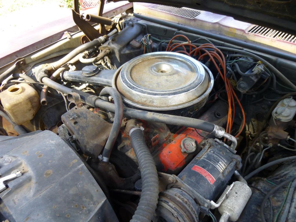

When I bought the car, the A/C was installed and working. Of course it was not an original compressor, as the whole engine part we're swap for chrome part. But except for the compressor, the rest of the A/C component look pretty original from my opinion, even if the POP doesn't make any mention about A/C. Does the dealer could have add this A/C after the car was bought ? Does a dealer installation look the same as factory installation ?
I notice that there's a little metal plate, screwed on the rear right side of the engine bay, just above the A/C hosing. Does this small plate is related with A/C ? If yes, was it installed from the factory, or could have been added by a dealer, during the A/C installation ?
On the following picture (not my car), this small plate has 3 screws, and is located slightly right of the hood hinges, just by the rubber sealant for the hood.
What do you guys think, about this A/C story ?

I don'T have the under dash A/C vents. I do have the regular clim control, including the A/C, and the cold air flow through the regular vents, everything looks to be right from the factory.
here are some pictures of the small plate I'm talking about, and my A/C hardware:

That's not a small plate under the hood weatherstip, it actually runs all the way under the cowl plate, and has a vacuum operated damper attached to it, that seals off the fresh air into the interior blower for MAX A/C.  There is a small filer plate that sits at the back edge of the damper that is part of the car structure to completely seal the area behind the damper all the way back to where the windshield meets the top of the cowl.  You won't find that triangular plate in a non A/C car even if someone replaced the firewall with the correct one for an A/C car.  Also non A/C cars have fresh air vents up under the cowl that are attached to the upper vents in the dash.  If someone converted your car, those vent openings and maybe their close off valves will still be up there in the very far outer corners of the dash.  Of course you would have to pull the glove box, or the dash pod out to be able to see if they are there or not.  Looks like a proper factory installation to me.

Your A/C unit looks exactly like mine - factory A/C
Thus I have to echo mark:
look on the passenger side front footwell, the plastic cover should have a cutout to accommodate the valve actuator
if you plan on rebuilding the A/C - may I suggest Classic Auto Air - they restored mine!
Also look across the core support, there will be a foam weatherstrip and if you can see into the fender along the support there will be a block-off plate with rubber gasket bolted to the core support

Mark answered the question that has nagged me since I bought my Z11 - is it factory A/C, added by the dealer, or an individual ? I pulled the cowl vent panel on my convertible, and low and behold, presto !
The cowl block off plate is right there, perfect example of what Mark mentions in his text above.
As a double check, I took a pic of my known (dealer invoice) X77, which could never have enjoyed the C60 A/C option due to the solid lifter motor, and you can plainly see where Fisher stamped the location (blank) in the cowl, and why it's there (to block off the upper cowl vent opening). Hope these are clear enough, and thanks to Mark for the clue as to factory originality. Just added to my own personal opinion of a Z11 convertible with A/C - -
