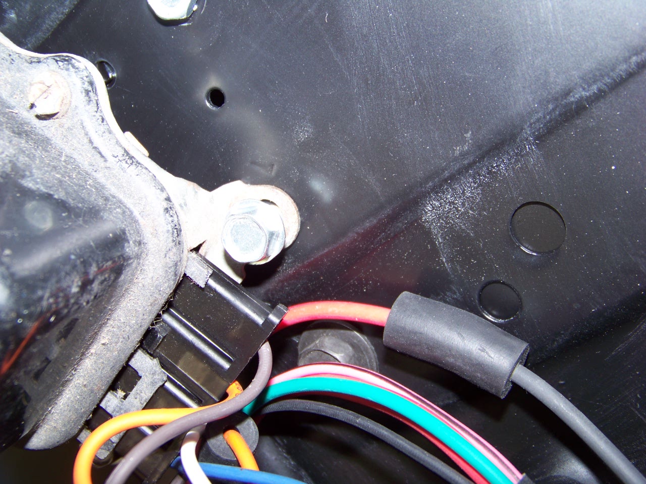

Drivers Windshield header detail...
Original rad support dated 7th week.
Converted std watershields to DLX version with plastic "cups" for the DLX door handle releases
Building up the rad support with wiring, vacuum hoses, and HL washer hoses.
Pass side of rad support
Drivers side of rad support -- will be changing the HL harness plug to original brown ones.
Mated the subframe and the body up.
trans and floors.
70z28lt1

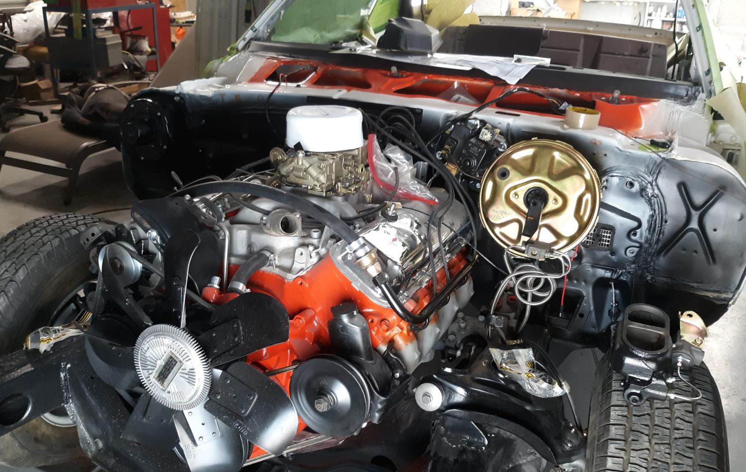

Is your fan on backwards??
Re: L78 M22 pacer - some firewall shots.
« Reply #33 on: September 15, 2021, 09:47:35 PM »
It is, the engine trans sub frame assembly was delivered to me as pictured.
70z28lt1
  • Posts: 133
« Reply #34 on: September 15, 2021, 11:51:21 PM »
That's funny!  Maybe even work better!  Hidden 5 HP.
